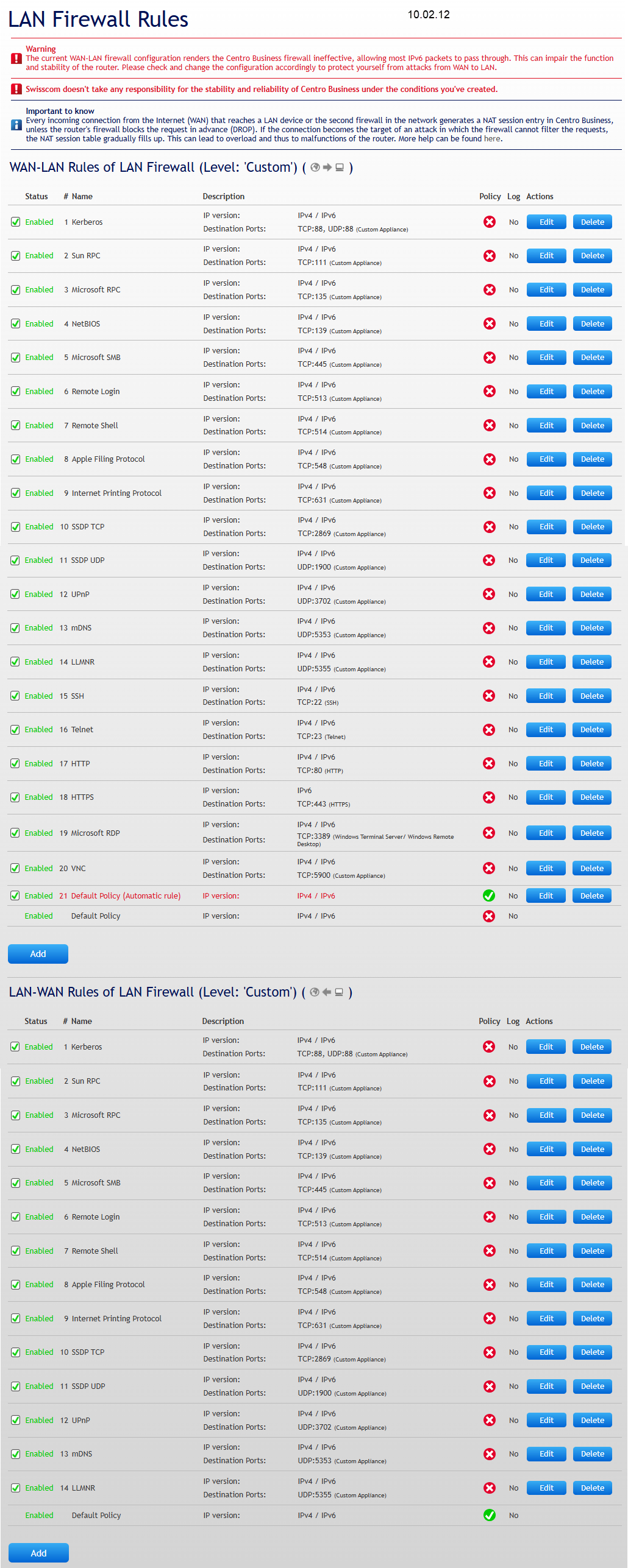

B18 / B19 / B40 "Balanced" ➜ B41 "Custom"​
With firmware version 10.04.10, the predefined firewall mode "Balanced" was removed and replaced by the "Custom" mode. The "Custom" mode allows flexible and granular configuration of firewall rules and forms the new standard basis for individual security and network requirements. Existing Balanced firewall rules are automatically migrated to Custom mode.
DETAIL: B18 / B19 / B40 "Balanced" ➜ B41 "Custom"
This applies in the case of a "Firmware Upgrade" or "Backup & Restore"
FW_GUI_Bal_to_CB3_cust

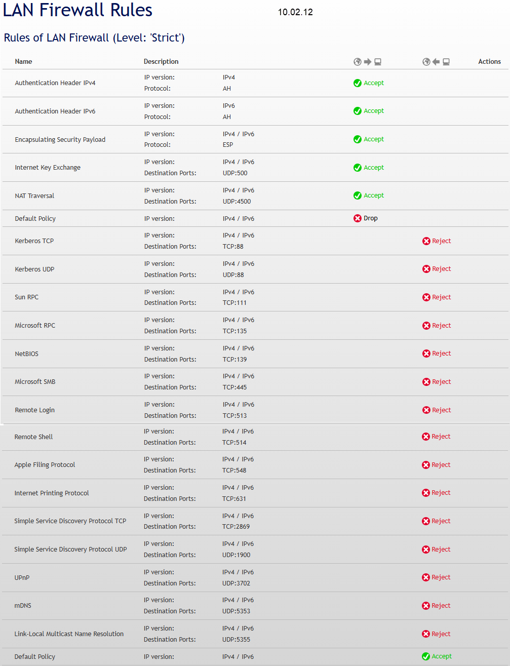

B18 / B19 / B40 "Strict" ➜ B41 "Strict"​
The firewall mode "Strict" remains unchanged after the firmware update. All existing firewall rules are automatically adopted. Rules that were implicit or hidden in the previous firewall are now transparent and visible in the new firewall (e.g. IPsec), without changing the security behavior.
DETAIL: B18 / B19 / B40 "Strict" ➜ B41 "Strict"
FW_GUI_stri_to_CB3_stri

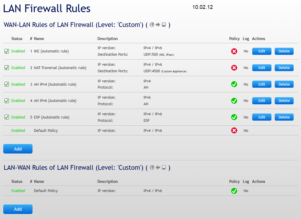

B18 / B19 / B40 "Custom" ➜ B41 "Custom"​
The previous firewall mode "Custom" with user-defined rules is migrated to the "Custom" mode with the firmware update. All existing user-defined firewall rules are automatically adopted, so the existing configuration is preserved and no manual reconfiguration is required.
DETAIL: B18 / B19 / B40 "Custom" ➜ B41 "Custom"
FW_GUI_cust_to_CB3_cust

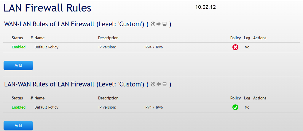

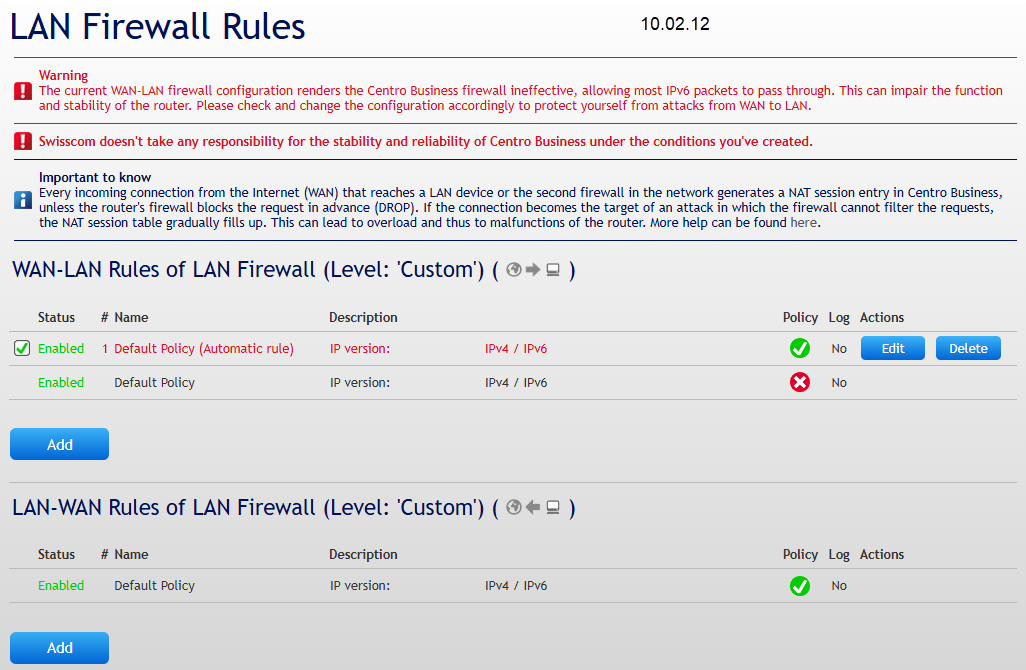

B18 / B19 / B40 "OFF" ➜ B41 "Custom"​
The previous firewall mode "OFF" is migrated to the "Custom" mode with the new firmware version 10.04.10. A rule that allows all traffic is automatically generated during this process.
danger
Firewall status set to "Off" or "Any to Any" is not an option!
Especially when LAN infrastructure is made accessible on the internet, the user is 100% responsible for protecting themselves and the system! The customer contractually agrees to this obligation in the "Special Terms and Conditions for Internet".
This rule is highlighted in red to indicate the high security risk and to make the precarious configuration clearly visible.
Be sure to adjust your firewall!
DETAIL: B18 / B19 / B40 "OFF" ➜ B41 "Custom"
FW_GUI_off_to_CB3_cust

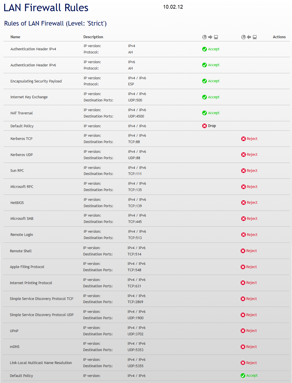

B41 "Strict" or "Custom" ➜ B41 "Strict"​
In the event of a "Factory Reset" on firmware 10.04.10 or a new commissioning of the Centro Business 3.0, the firewall is activated in "Strict" mode by default. This automatically ensures a high level of security after the reset without requiring manual configuration.
Use a current backup file to perform a restore of the previous configurations.
DETAIL: B41 "Strict" or "Custom" ➜ B41 "Strict"
This applies in the case of a "Factory Reset"
FW_GUI_CB3_stri_after_reset
